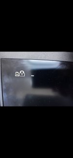

my problem is removing bios password about it unlock bios is required

maalesef baska bir ITE mevcut degil
